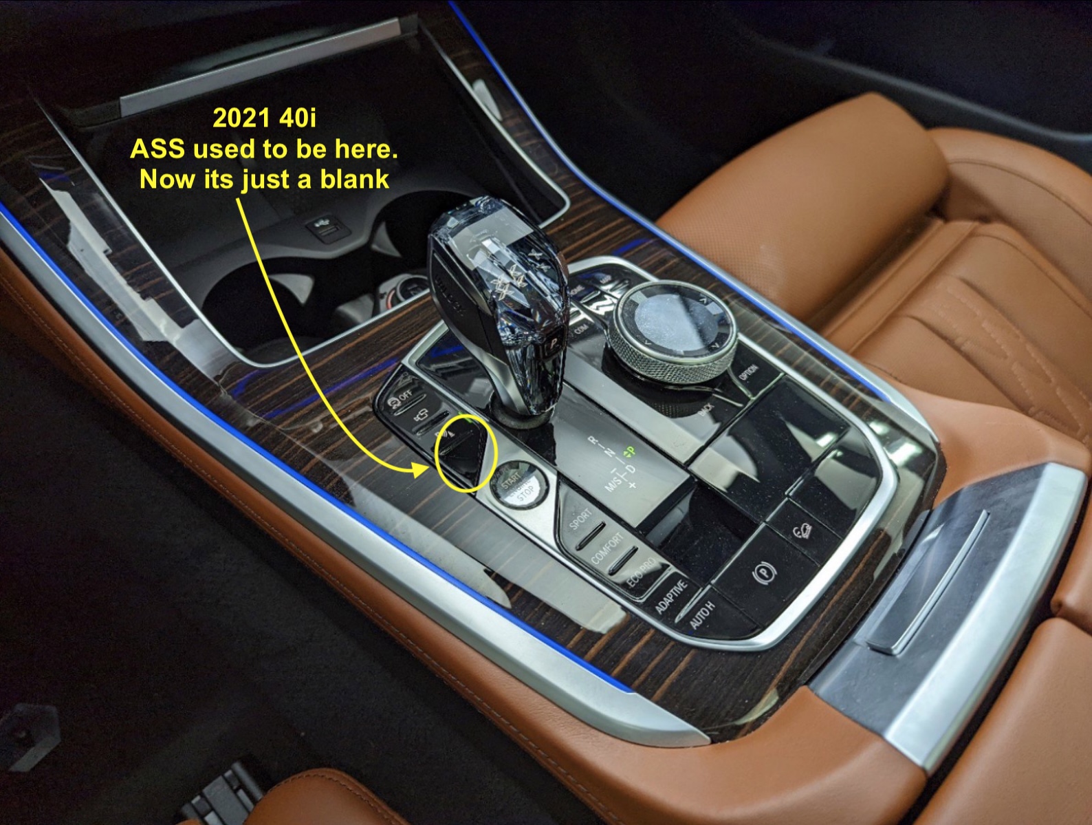

Marty in NY wrotewait what they removed the button to disable it? so fail worst feature ever poor startersI have a '21, the button to turn if off is gone so I used Bimmercode to disable it full time regardless of what mode I want to drive in.
mikekay wroteYeah, they zapped the ASS On/Off button on the center console somewhere in the 2021 model year. They added new hardware for the gen/starter and 48v battery to support the ever constant ASS. I have to say, they did a great job, if you are not really paying attention, you don't hear or feel it shut off or restart.wait what they removed the button to disable it? so fail worst feature ever poor starters
