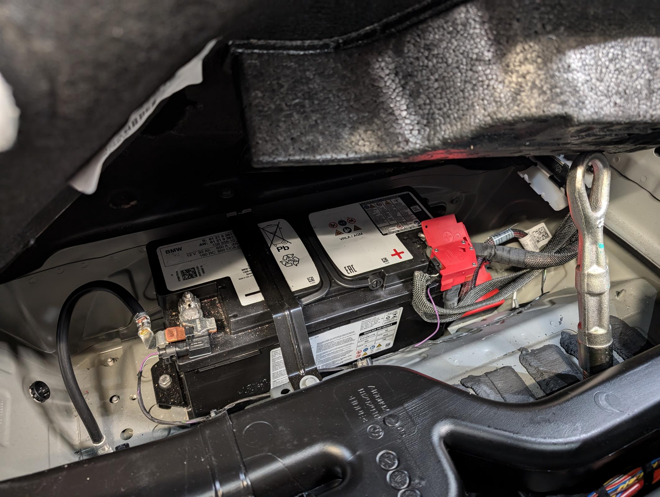

I will check tonight if there is a better value for my car.
With the car running it indeed closes like normal. Where can i check the battery like you talked about?
The car has soft closing installed so that wouldnt be a problem.
07-26-2024

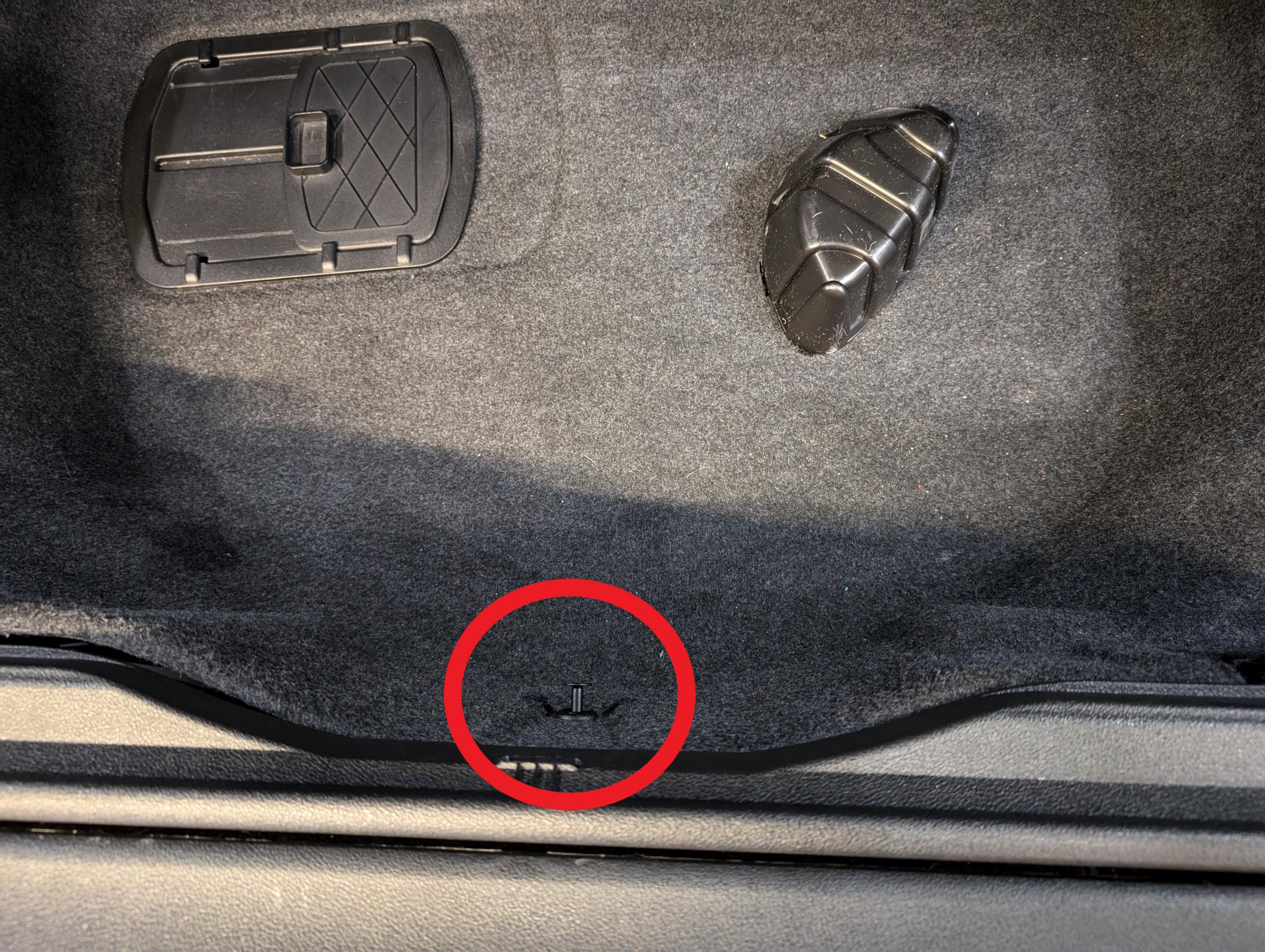

There are three simple steps to checking and charging the battery:
1) Remove your wheel repair kit from the under-trunk at the rear.
2) Remove the single Clip Retainer as shown in the image below.
3) Lift the carpet and voilà! You now have access to the battery to install your charger.
Note: It's usually best to use a low-amperage charger (2 to 5 amps). It takes longer, but recharges the battery longer and uses it less.

I can have a x5 45e its on the side in the boot. I can get to it fairly easy. But how did you knew it was only 25%?
07-28-2024
I simply plugged in my battery charger to charge the battery, and saw that it was only at 25% charge when I started the process. Most battery chargers display the battery charge in real time. I used this model of charger bought on Amazon, which is compatible with several types of battery:
Checked the battery today. 100% charge 85% health. So battery is fine.
