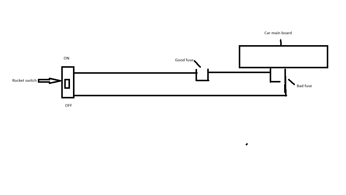

Anyone know the exhaust fuse location? Have the 11Mode controllers, don't want to bother opening them each time. Figure I can open them and pull the fuse so they stay open.
You should get the MAD valve controller since it has memory function.
You can wire the fuse in parallel with a rocket switch, stick it in glove box and can have memory function with 11mode controller. Turn the switch on (connecting the fuse), valves are in stock mode. Press open button on 11mode remote and turn switch off : valves fully opened.
Got a DIY guide? I pulled fuse 203 for now, so they are open 100% of the time.
Pretty easy. Use a broken fuse, connect 2 wires to the legs of the fuse, make sure they dont touch to each other. Connect the other end of the wire to 1 leg of the good fuse that you took out. Connect wire to the other leg of its and go to the rocket switch. Connect the other wire from broken fuse to rocket switch also. Wrap the good fuse and tuck away. Plug that broken fuse back into the board.
Stick the rocket switch to glove box or convenient place you can reach to turn on / off along with your 11Mode remote.
With that setup in place. Now you can :
- Rocket switch turn on: fuse connected and you have stock vavle mode
- Preess 11mode remote to open vavle and turn the rocket switch off: fuse disconnected and Vavles fully opened and stay opened until you turn on rocket switch again.
The below illustrates the setup:
