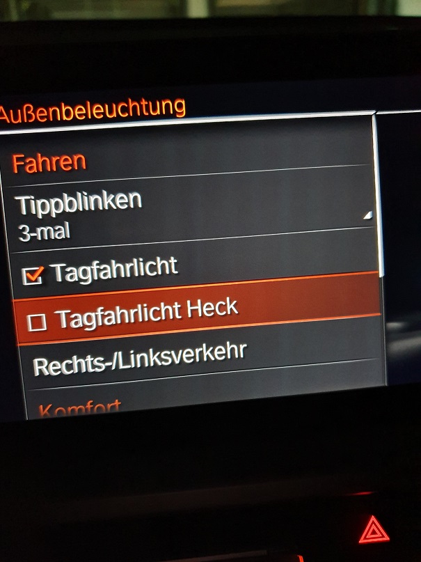

I have managed that in the IDrive menu the daytime running light for the taillights is displayed but unfortunately I can not activate it, is there still a control unit which must be coded?

Can you share photo of IDrive menu?
08-21-2019
After the coding in the HU_MGT this menu appears but unfortunately I can not activate the taillights as DRL
08-21-2019

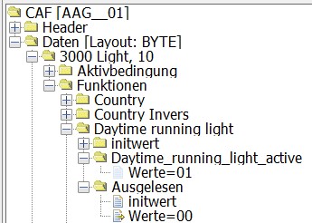

When you cannot select the checkbox, you are missing a setting in another module. I think of HU_MGU as holding the toggle for a setting that is usually enabled in other modules. If the other module has it disabled, you get a non-functional checkbox.
My guess is it is in AAG.
08-21-2019

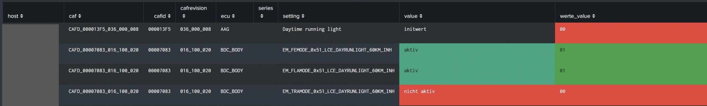

Thank you for your answer. Unfortunately, there is probably no AAG controller in the G20 but I have found the 3 latter points in the BDC and coded unfortunately without success. The point with the TFL Active is unfortunately missing entirely
08-23-2019
AAG is trailer hitch module.
May want to search tagfahrlicht as well.

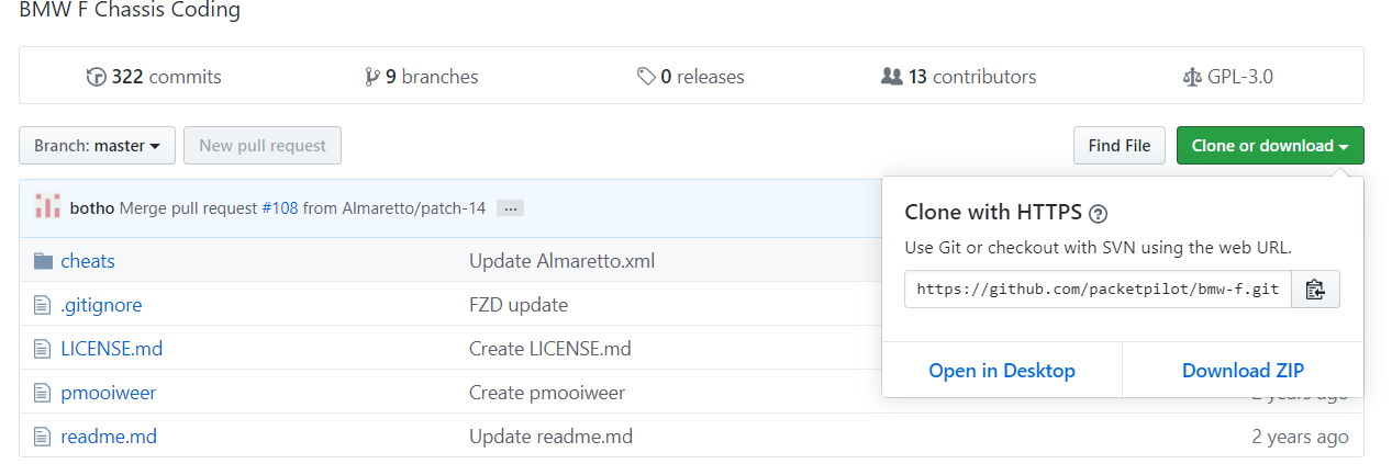

I must be missing something obvious - how do I download the xml file? Do you have to have a GitHub account?
09-13-2019
No account needed unless you want to contribute.
There are multiple ways. Here are two:
1. Download zip. https://github.com/packetpilot/bmw-f
a. Extract bmw-f-master.zip
d. Grab xml from cheats folder
2. Go to cheat page: https://github.com/packetpilot/bmw-f/blob/master/cheats/jokinawa.xml
a. Copy lines 1 through end
b. If already have xml and updating, replace text and save
c. If starting new, open text document --> paste --> save as xml.
09-13-2019
Thanks Almaretto. I didn't go high enough up in the directory structure. Much appreciated.
