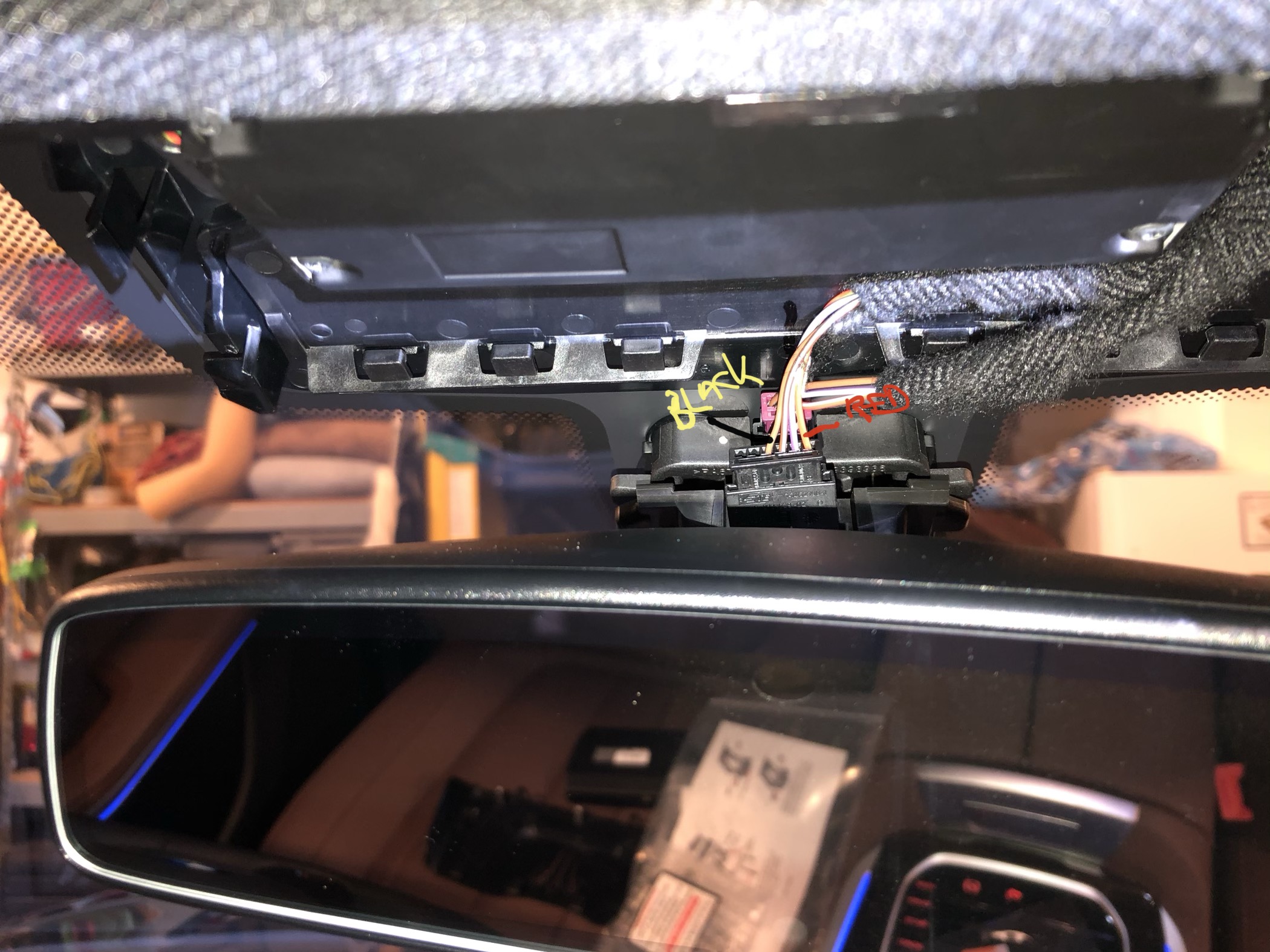

jr1 wroteHope these diagrams help you out.Does anyone have a photo of the proper ports on the molex plug located in the mirror housing into which the black (ground) wire and the red (+12 volt switched wire power) wire of the MirrorTap Power Cord can be inserted into without causing other issues?
The red wire goes to the red/green wire.
Black wire goes to brown/black wire.

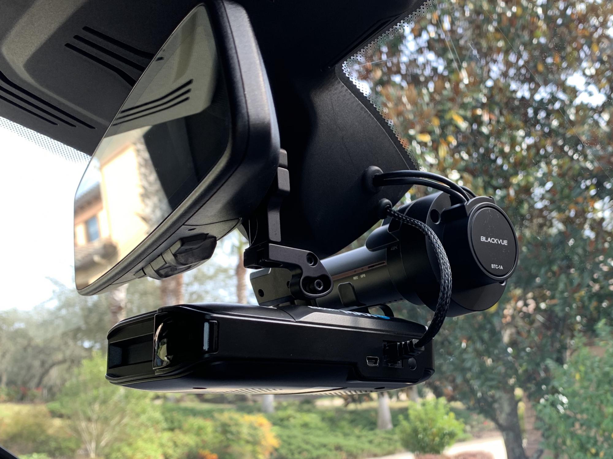

Thumbs wroteThanksThat's a nice installation!
Is the cable the factory cable?
Are the grommets/o-rings at the mirror something you found locally?
I'm guessing you ran the wire across the top of the windshield, etc. Did you have to remove trim other than the piece at the mirror?
Thanks!
I had to remove numerous trim pieces: the A Piller (you need to run the wire behind the air bag), trim pieces under the glove box to access the fuse block, the D piller to run the rear camera wire, etc. I did a lot of searching on this forum to find explanations and photographs.
I buy a lot of stuff on Amazon as it is easier to buy there than drive to numerous stores looking for stuff. The grommets were one of those things. A lot of the stuff I order I will or can use for other things down the road. See these links for some stuff I ordered to make things easier.
I drilled holes in the mirror trim piece, ran the wires through appropriate sized grommets and after this forced the grommets into the holes in the mirror trim. Then ran the wires where they needed to go. Any wires that needed to be connected together, such as the radar detector plug wire to the longer wire was done AFTER running the wires through the grommets as I wanted the grommets to be as tight as possible and sometimes the connectors are too big to fit through the grommet or the hole.

jmcmathortho wroteHi, how did you get the plastic covers off behind/above the mirror as it looks like we have a different cover than some other posters I've seen. I'm just a leery about busting something. I was able to partially separate the narrow piece directly behind the mirror, but then above the mirror it seems as though there is a separate cover and that is what I'm afraid of breaking. Please advise.I just installed the wiretap to wires shown in picture to my 2020 X5 M50i. I can confirm it works and will shut off about 5 min after car is turned off. Just make sure you grab the wiretap flat connectors with some needle nose pliers (because they can be hard to push in) and push alongside the wire where it will make good contact to the metal shroud (I had to disconnect the molex plug and turn it backwards to get the best angle to insert the wires).

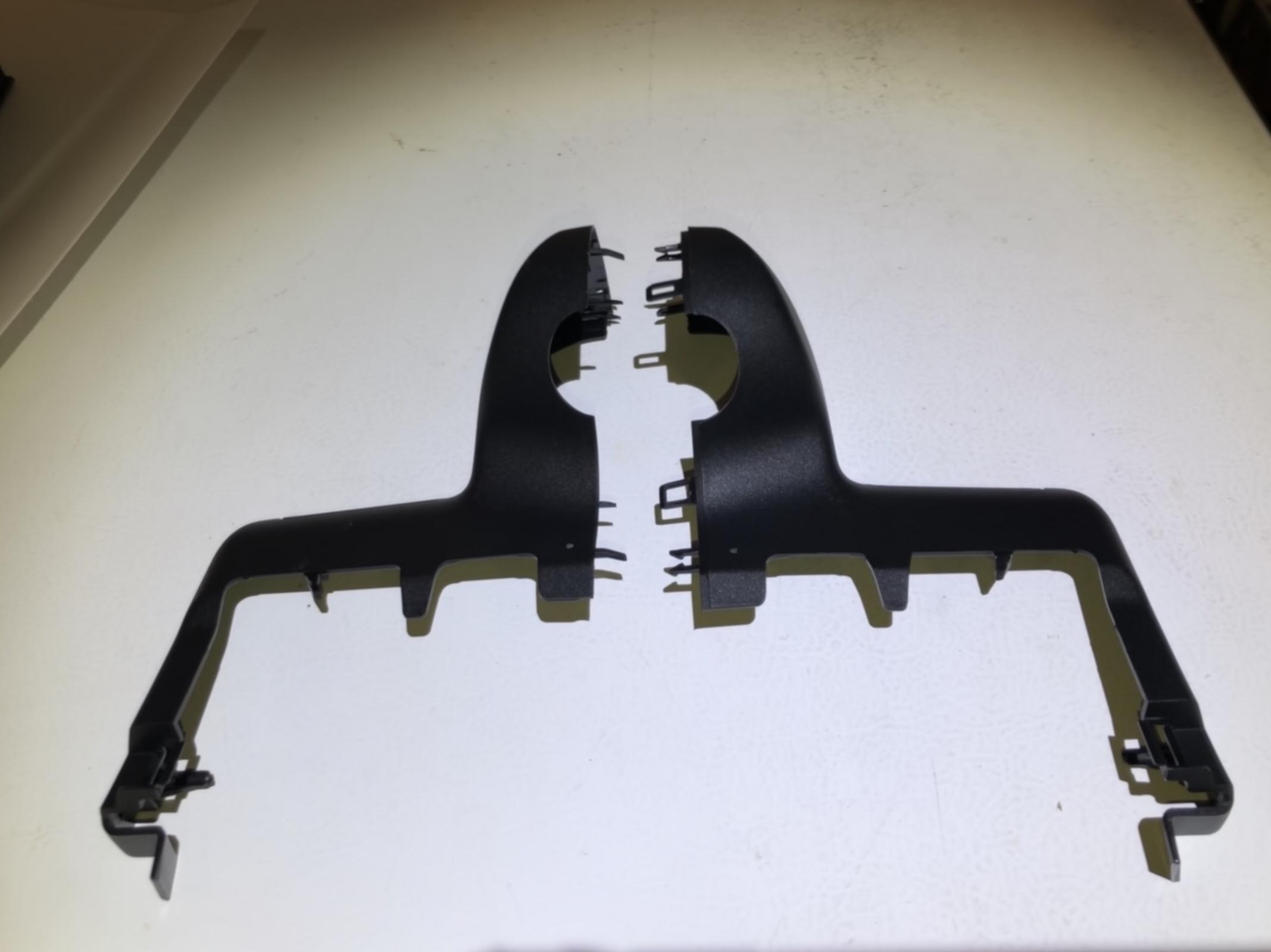

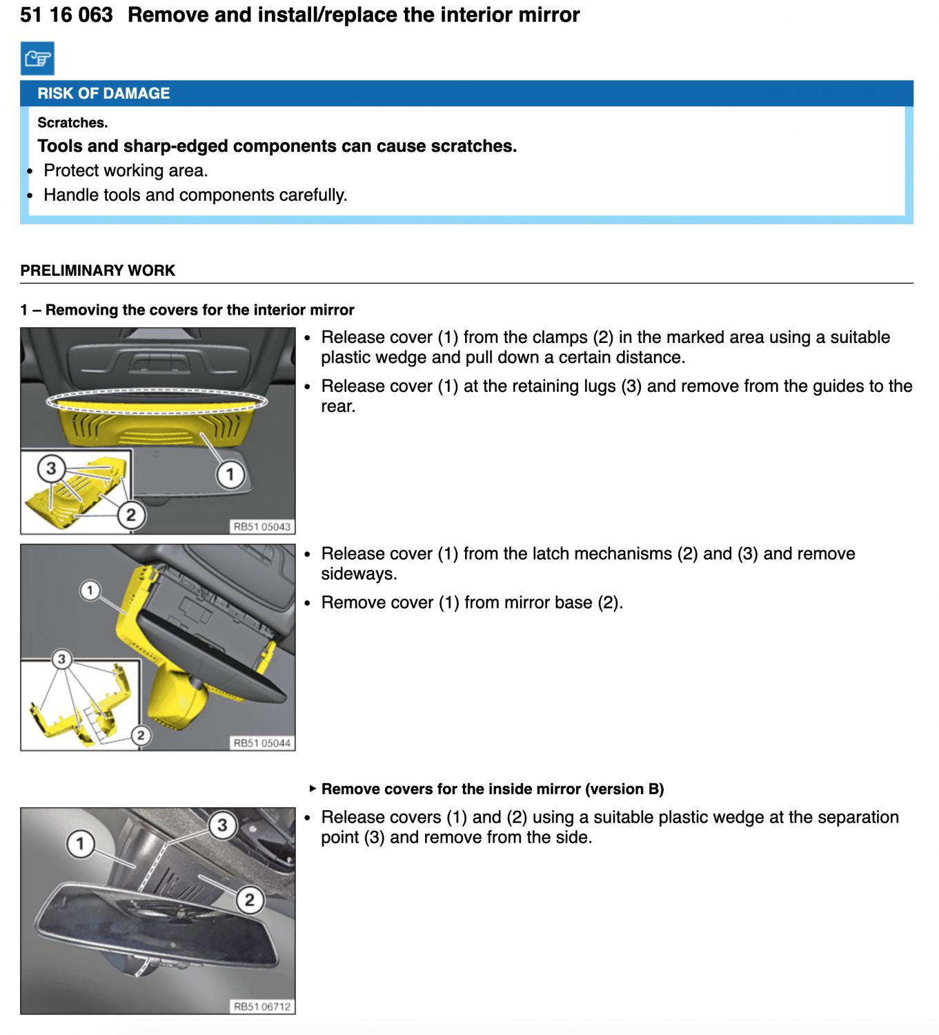

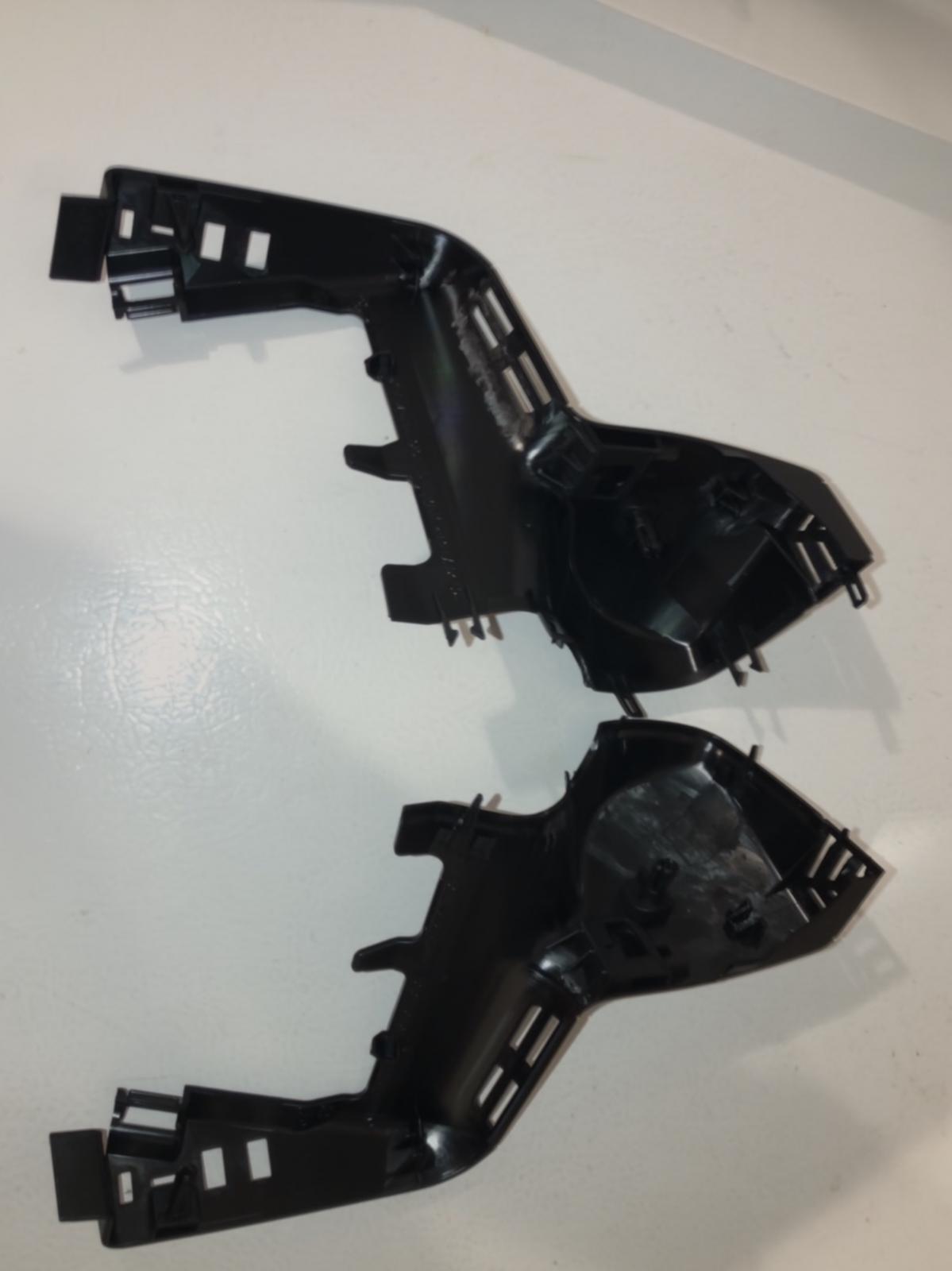

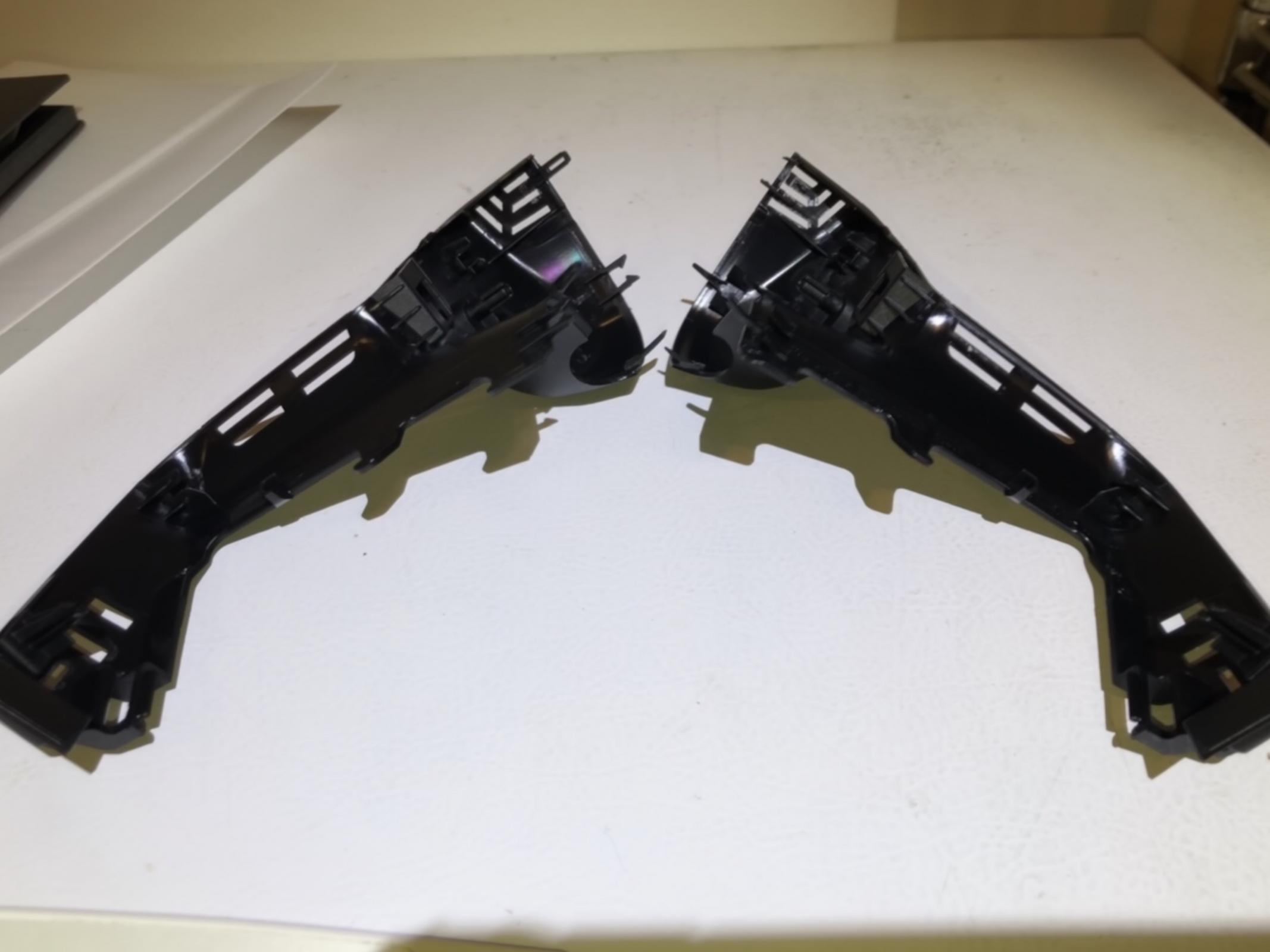

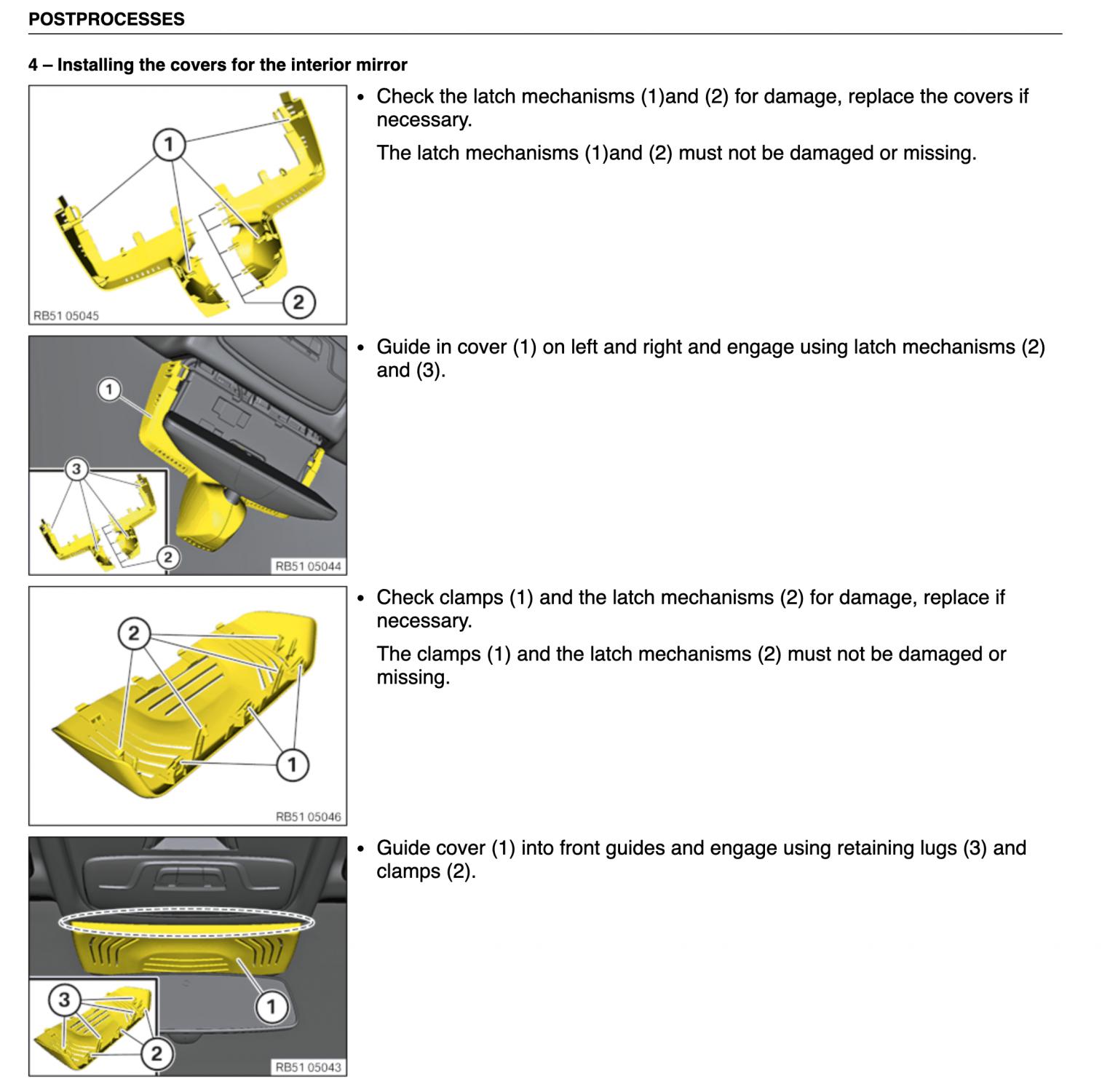

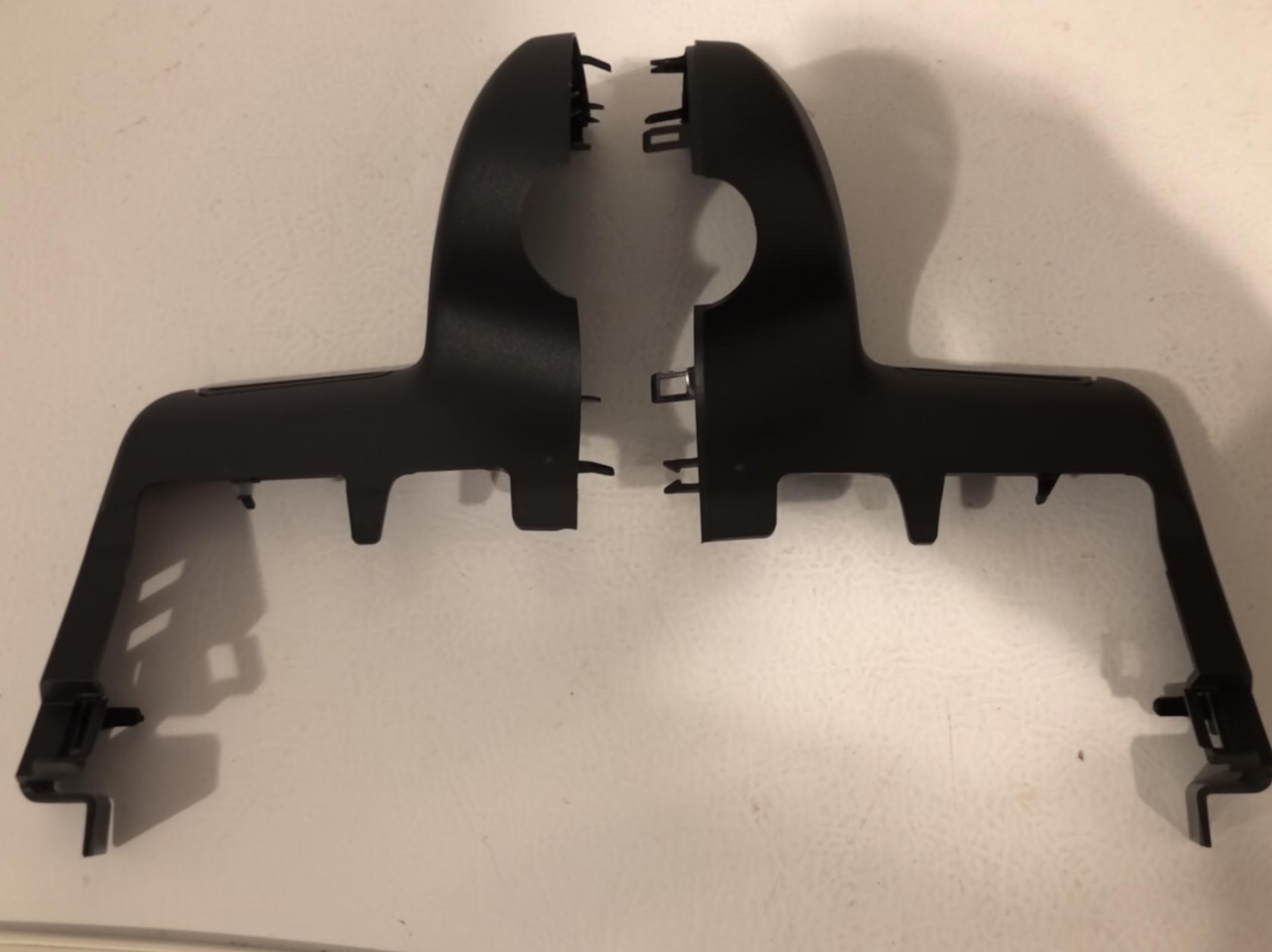

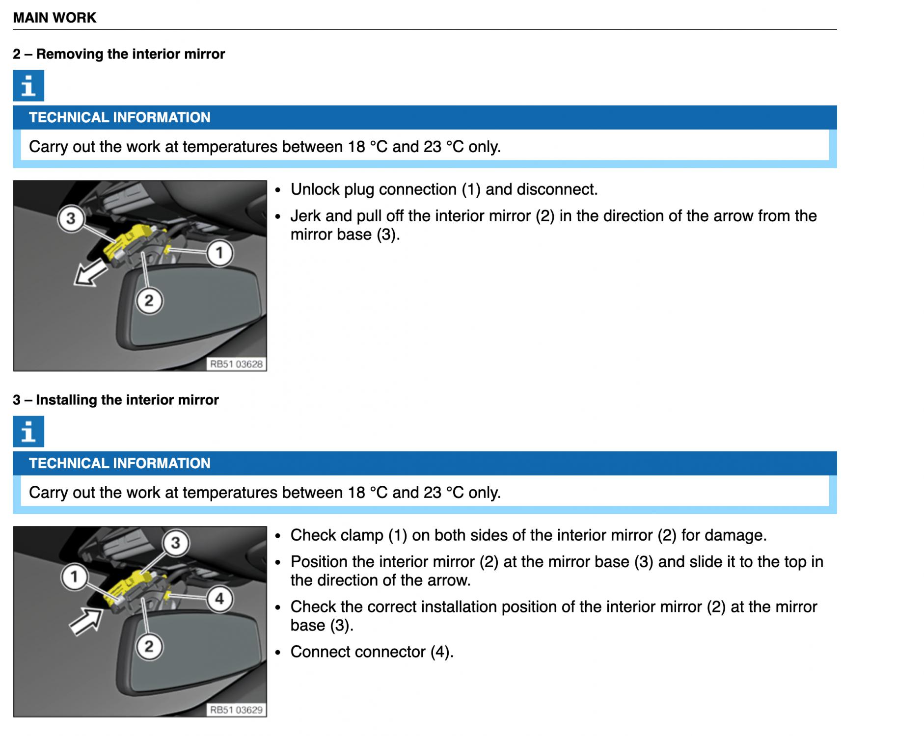

radmjk wroteGood info...thanks! Looks a bit tedious and lots of little plastic springs to break. Probably a good project for a warmer day.Well, I found this info seen below which should help me out and those looking to access the mirror wiring for the mirror tap.
The first thing I did was pull off the Rectangular Cover Above the Mirror the one with the vent slots. I pulls off fairly easily with moderate downward force. If I remember correctly from a week ago it had some metal sing clips holding it in place and did not appear like it would break those clips. Then the plastic shroud around the rear view mirror against the windshield pulls apart mid-line with moderate force, in fact I was afraid of breaking the plastic clips and was separating the edges at the top of mid-line to see where the clips could be unhooked when all of a sudden it unsnapped apart......... the 2 pieces flew out of my hands... I thought oh crap! I just broke a part on my wife's new car and I will never hear the end of it. Amazingly, with the help of the Orthopedic Gods it was not broken and I was able to photograph the pieces to show her as proof if she ever questioned my re-installation. The re-installation was pretty easy, I just lined up the plastic prongs and it snapped together. The rectangular vent then popped back in place with a firm push. I will post the photos in the regular link as this private message does not allow me to attach photos for some reason. Good Luck, JM
Wish I took pictures but I couldn't pull apart the molex connector and I couldn't get the correct angles to push the blades from the top so I went from the bottom.
