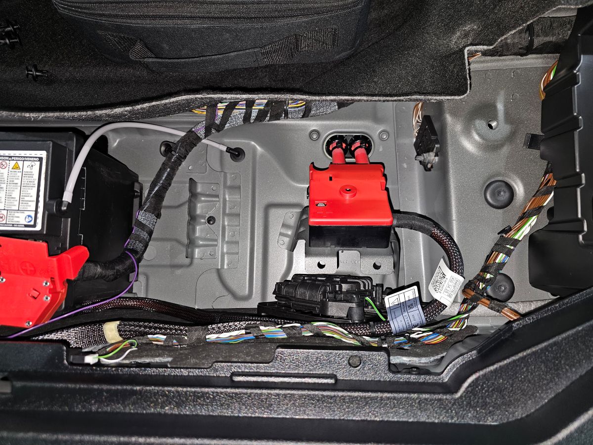

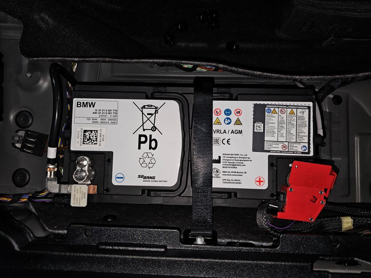

Has anyone attempted to install a DC to DC charger for an RV trailer? I have a 2026 X5 M60i and I know the battery is in the rear, so I'm thinking this might be easier than running cables to the engine bay like most cars\trucks.
My concern is in the complexity of the battery connections and the risk of damage to my alternator, battery, or other parts by not properly making the connection to the DC-DC charger.
Has anyone successfully done this and know which posts\connecting points I should use? I included pics of my battery for reference.

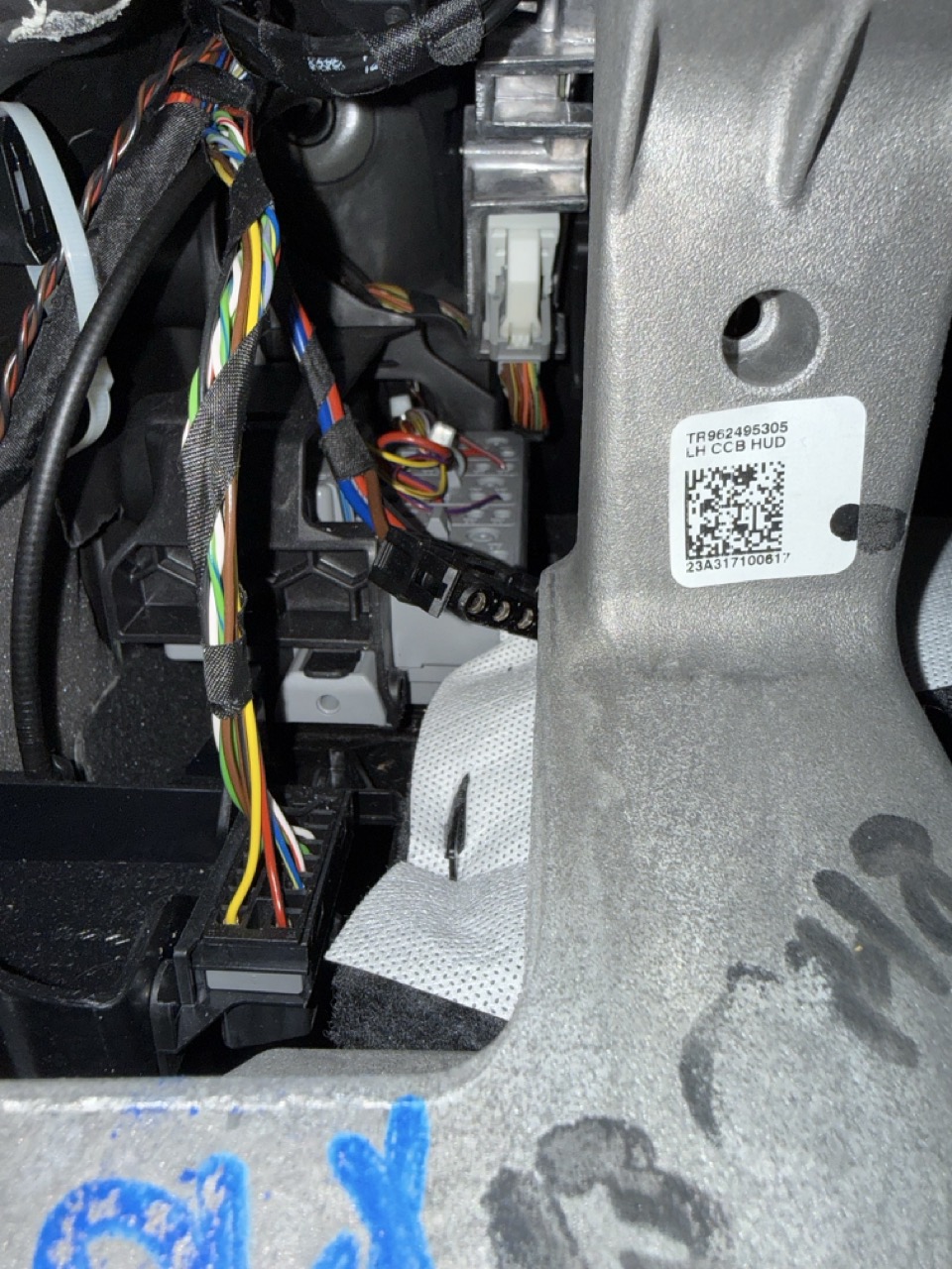

I have an Orion XS in the trailer, set to 10A, to charge a LiFePO4 battery from the X5. The 7-way connector’s +12V aux in the X5 it draws from is only fused at 15A. If you’re using a wireless brake controller (Tekonsha RF, Curt Echo, …) on that wire to actuate the brakes with only the car’s AGM battery available as the Li one in the trailer should be isolated, you’re already at the limit and a DC-DC charger would overload the circuit. With AGM on both ends it’s not an issue as they can both provide current.
The 12V wire on the dedicated brake controller connector in the steering wheel housing on the other hand is fused at 30A, I would use a wired brake controller on a dual axle (4 electric brakes can draw up to 12-16A) trailer with Li for that reason. Of course it also leaves the 7-way 12V fully available for charging with DC-DC.
02-11-2026
By two screws, the cubby hole comes out and the brake controller harness was right there in my 50e. You can get the necessary parts from ECS tuning for a plug that fits: part #164439 x4 and the male connector #1512776.
Someone made a pretty clear diagram of the wiring order for a Tekonsha harness, which I also attached. Hope this helps someone.

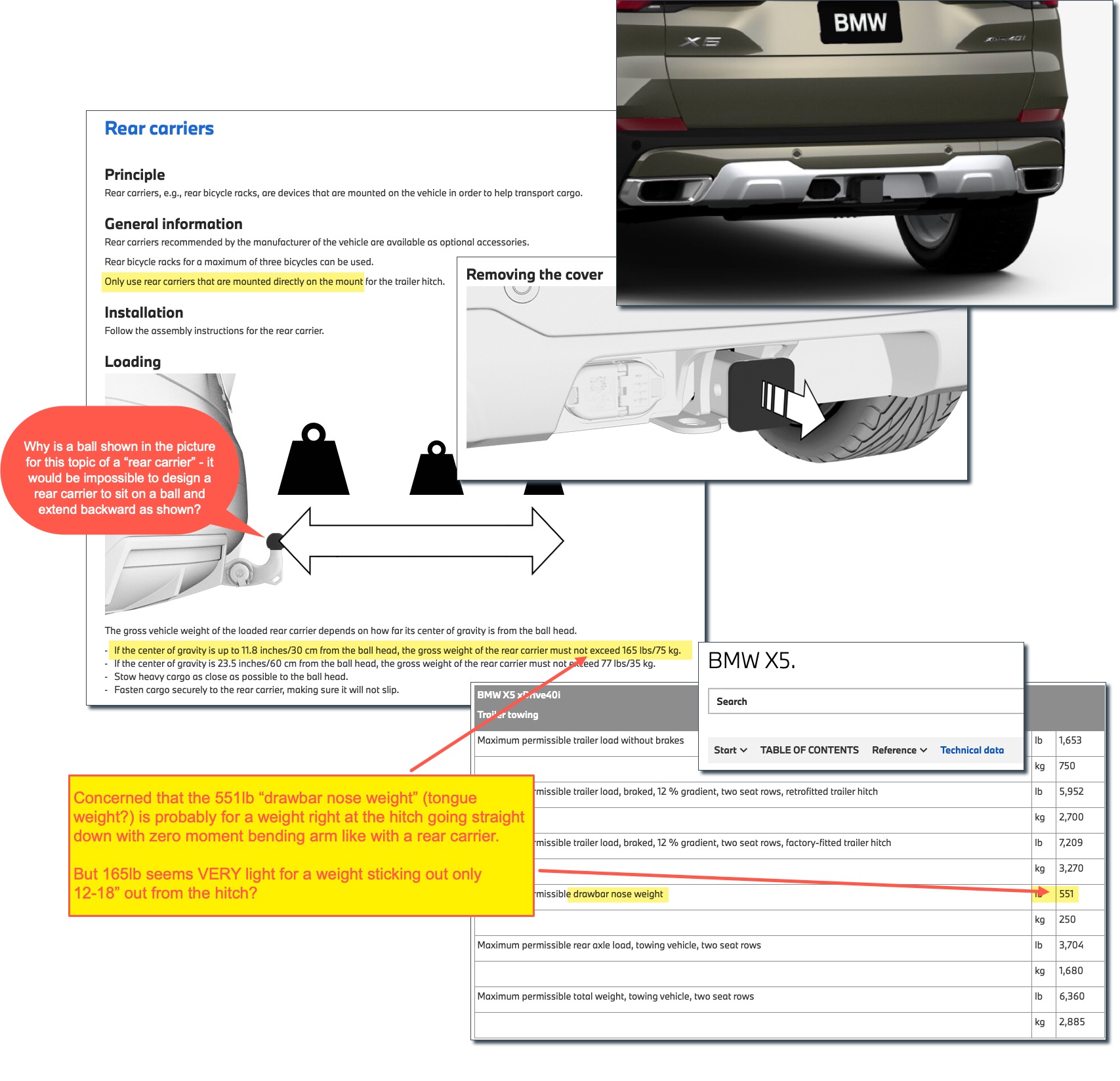

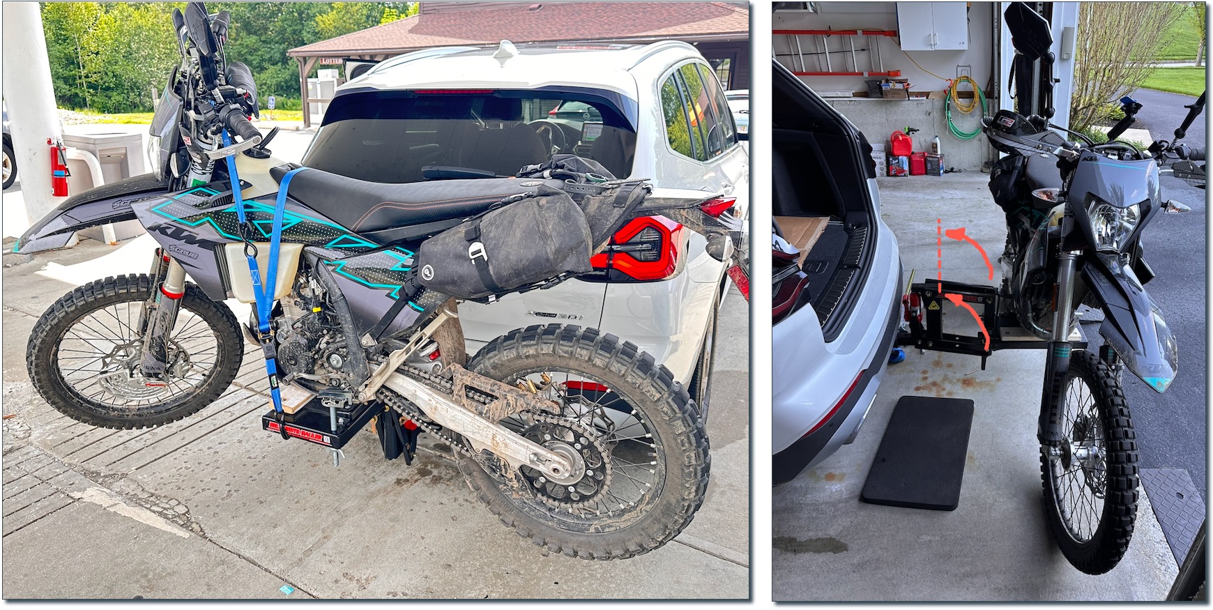

Lots of good info in here on brake controler, etc. I'm looking for any thoughts around the confusion I'm seeing for a rating to carry a motorcycle hauler on the back of my 2026 X5 x40i. I put on on order SPECIFICALLY to get the factory hitch because I didn't want to have to add a hitch bar on after the fact like I did on my wife's white 2022 X3 shown in the picture. For the X3 I paid $1200 to add a $300 Curt Class III hitch bar, which replaced the rear bar in the X3. I assumed the X3 was rated for 400lb tongue weight so my dirt bike (230lb) and Moto Hauler (60lb) is well under that. It does cause the rear of the X3 to sag a bit but its felt stable and I've used it 6 times and 500 miles last year.
But I decided to get my own X5 with a hitch option so I can haul my own bike in my own car. I went with the X5 assuming it was more substantial than the X3 which the towing spec shows... but my concern is the "Rear Carrier" details in my 2026 X5 owner manual cast a lot of doubt on whether my 290lb Moto Hauler idea is too risky in the long haul.
Here in the US the X5 factory hitch option DOES NOT come with that gooseball-swing thing. It's just a receiver. So why does my 2026 X5 online manual show a ball in the picture on the Rear Carrier page?
Does anyone know how to reach BMW factory to point out silly inconsistencies like this? It would be impossible to put a rear carrier onto a ball?
The tongue weight rating for the X5 (both x40i or M60i) is 551lb according to the online owner manual. But that is for a weight going DOWN at the hitch. A rear carrier extends the weight out behind the vehicle creating a bending moment that tries to rip the carrier weld apart. Now that my factory order 2026 X5 is built and in transit to me I'm worried about what I have done!
Any ideas from those (only in the US?) who have the factory hitch rather than the gooseneck thing?
02-17-2026
BMW has always been vague about towing in the US market. They largely ignore the American hauling crowd - meanwhile in Europe cars like the 5 Series tow regularly (no hitch option in the US). So the manual inconsistencies don’t surprise me.
At 390 lbs you are well under the 551 lb tongue rating. Yes, a carrier creates more leverage than a straight vertical load, but you are not in extreme territory. For context, I have towed 800–900 lbs tongue weight for 70k miles on an X5 with zero signs of hitch stress.
Keep the carrier tight to the receiver, torque everything properly, and you should be fine. Just check any potential sign is stress on the hitch.
02-17-2026
bono wrote
...At 390 lbs you are well under the 551 lb tongue rating...
I fixed a typo above in my math... the combined bike and rack weight is 290lb not 390lb and I'll have to measure but its center of weight is probably 16" from the car which is similar to the 11.8" measurement BMW gives from the ball (if the ball could be present).
I think when you tow a big load with an 800lb tongue weight, that weight is right at the ball, which is 5" from the hitch let's say. Or maybe the ball is further out for a big load like that?
In my case the tongue weight is only 290lb, but its more like 16-18" away from the hitch... I just hope they didn't weld their factory hitch to the bar in a dumb way where it has no twisting strength. By comparison the Curt class III hitch is really beefy for resisting bending and it fastends right to the factory side rails with 4 big bolts.
At this point I can only hope or I will have ordered a big expensive car that requires me to find a way to cover a trailer outside in New England :-(
