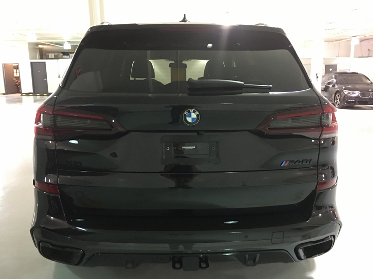

I take delivery on March 13 and will install it same day. I Will update with steps involved to install the spoiler. This picture is without the M roof spoiler.
03-01-2021
Looking forward to seeing your conversion. I see you murdered out the emblems.

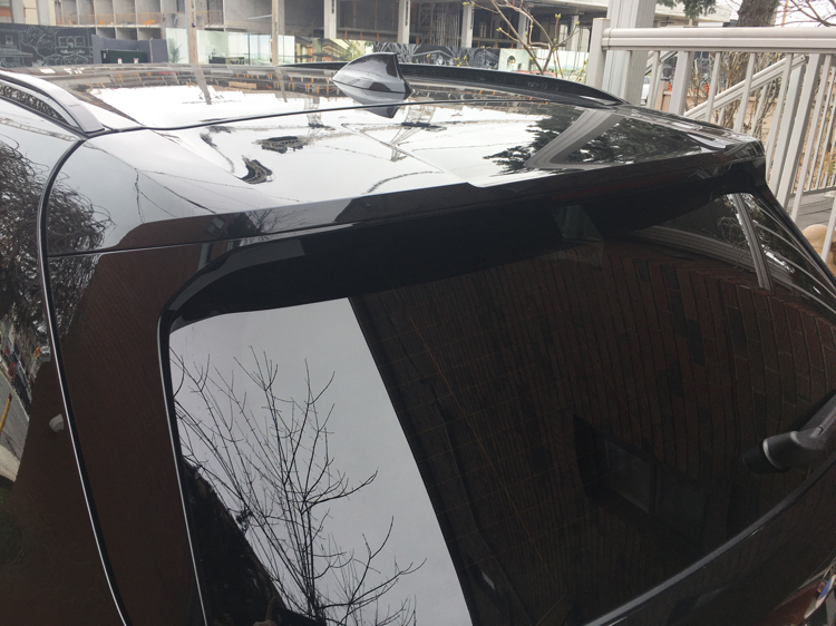

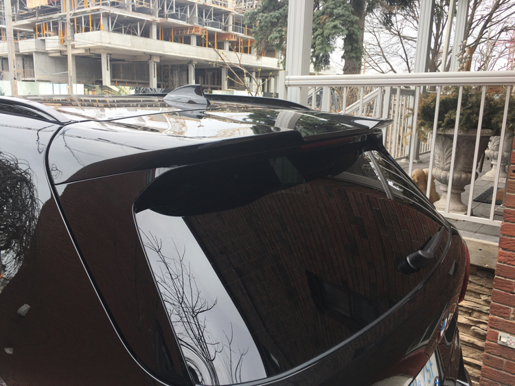

Its pretty amazing how big of a difference the X5M roof spoiler changes the way the rear end looks. Once you've seen it with the M spoiler it just doesn't look right without it.
Alan

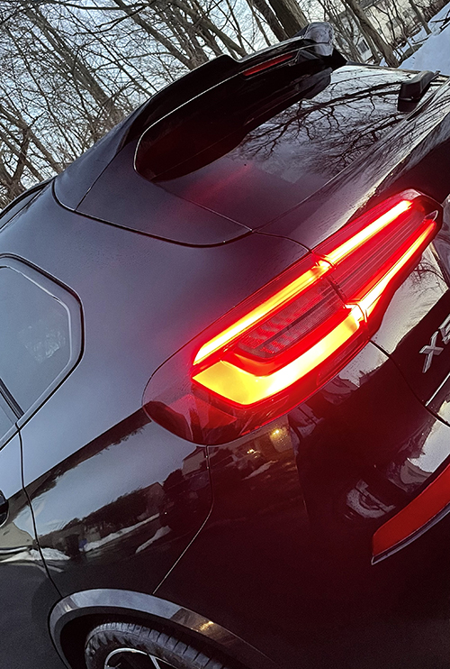

Agree.
Just installed mine.

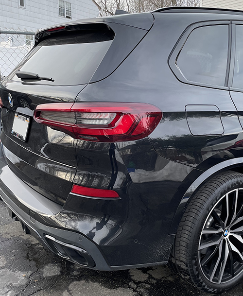

Before and After of the X5M Roof Spoiler:

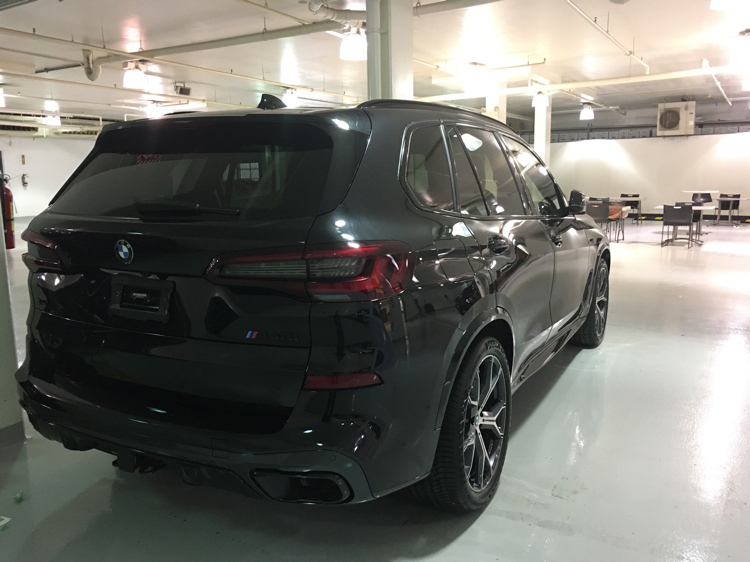

r33_RGSport wrote
Agree.
Nice wheels, what are the specs?
03-18-2021
I think these are the spec. :)
22x9.5 +15
22x10.5 +20

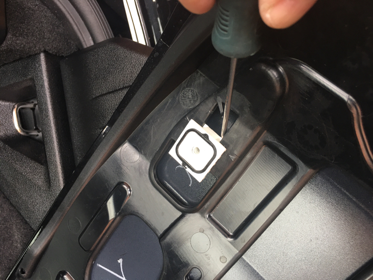

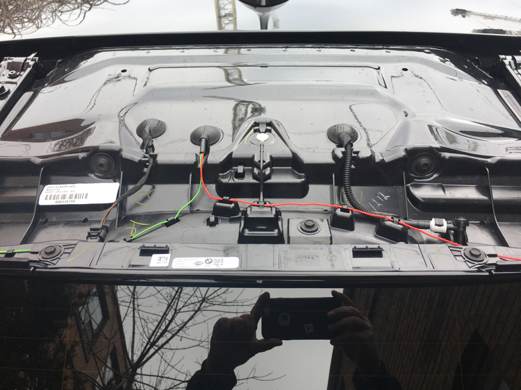

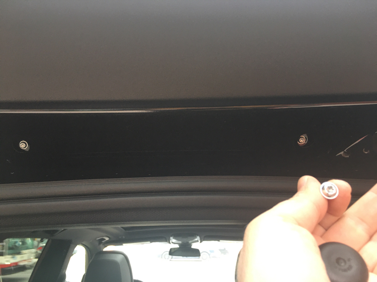

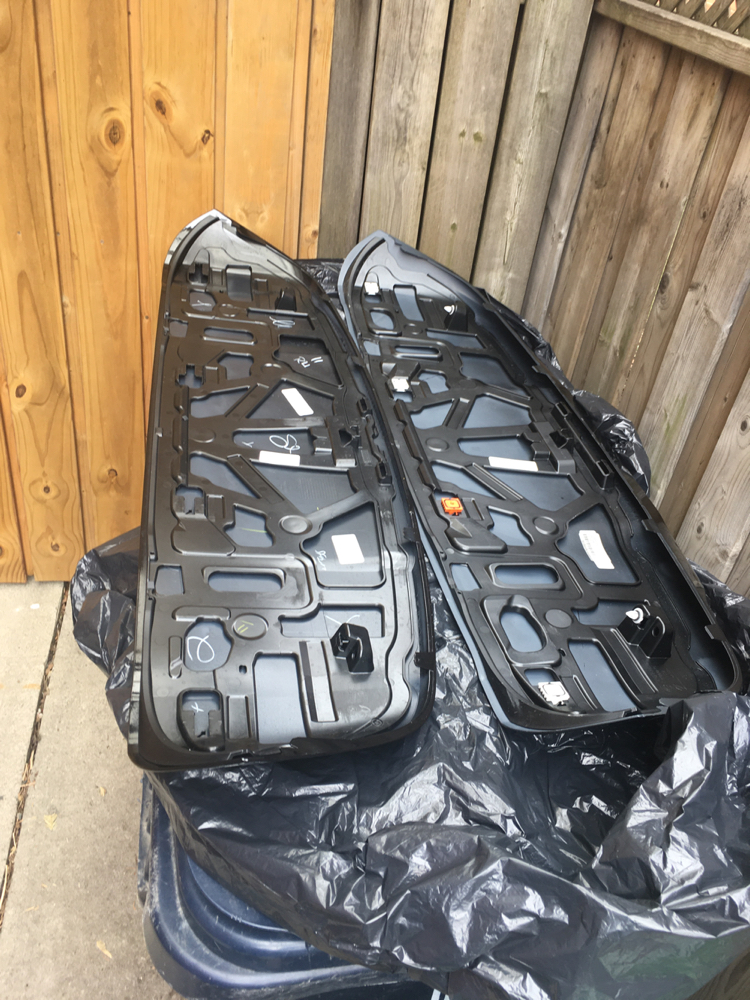

Hi Guys I finally picked up my X5 and the first thing I did other than driving it home is replaced the rear spoiler with the M version.
- remove 4 rubber covers and 4 T25 Torx screws located under the tailgate middle. Leave the 2 screws 1 at each end. Picture 1

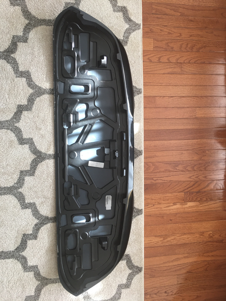

- standing behind with tailgate closed pull the spoiler towards you. Start from one corner. It's a little tight don't worry it will not break if you hear a pop it's the white clips disconnecting. Picture 2

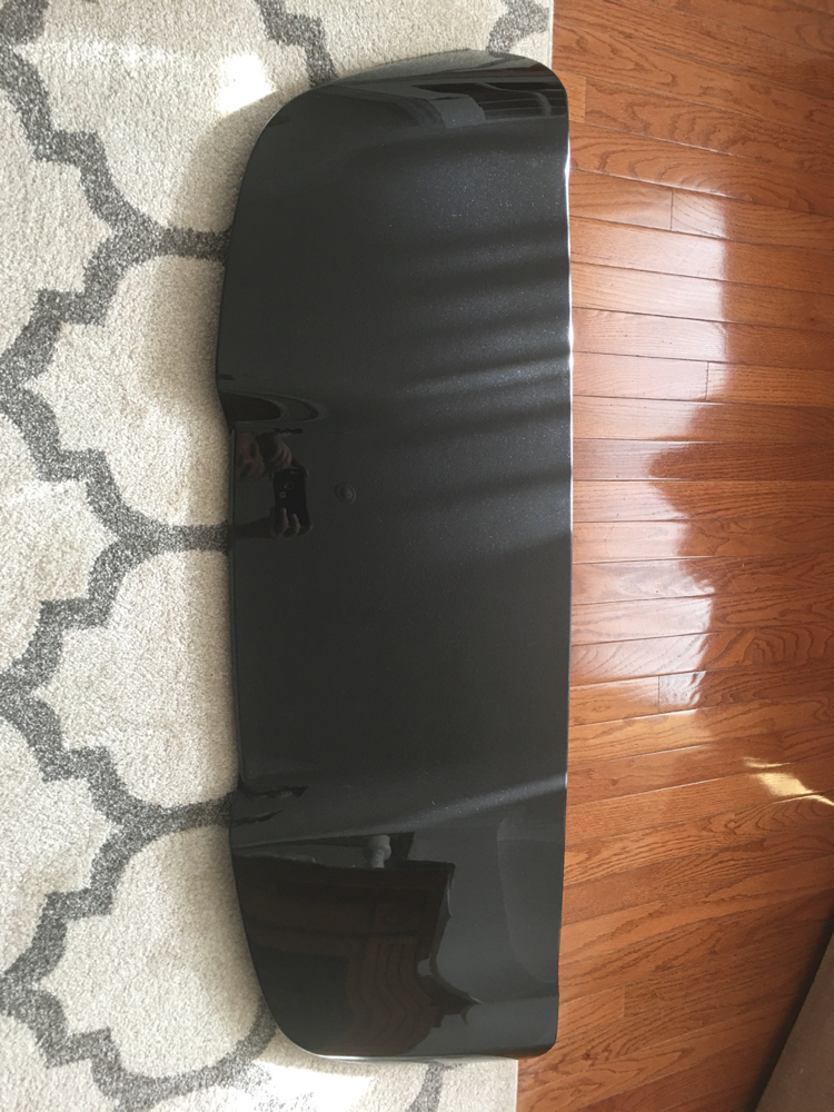

-swap the 2 white clips and 4 spacer tabs. Make sure to take a photo for location because they need to go exactly same location on the M spoiler. Picture 3
-to reinstall tailgate closed place the spoiler back on top, there are 5 tabs 2 on each side and 1 in the middle. Align tilt the spoiler up just a bit for the tabs go in them lower and push forward. Picture 3

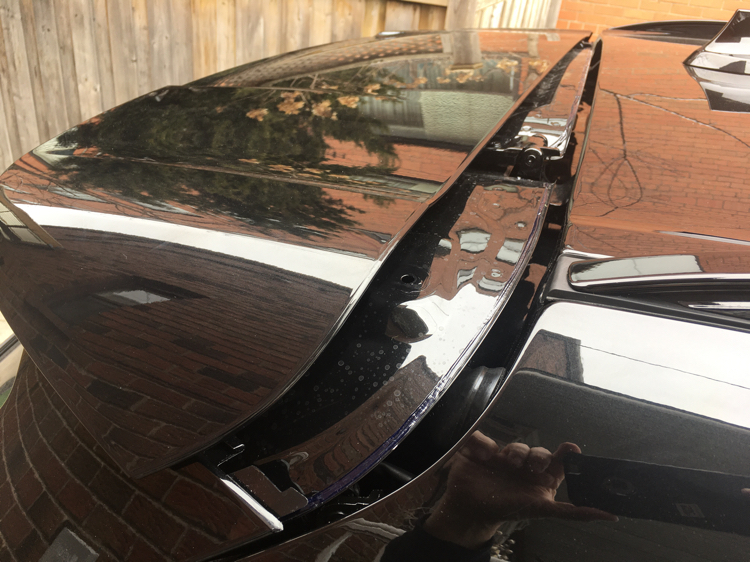

- open tailgate and put screws back and rubber covers. Picture 4
(Use a magnet bit because screws can fall inside tailgate. when removing screws manually lower tailgate to prevent screws from falling inside tailgate but if they do don't panic just use a magnet screwdriver to reach it. )
Good luck 👍 took me 30 min.
