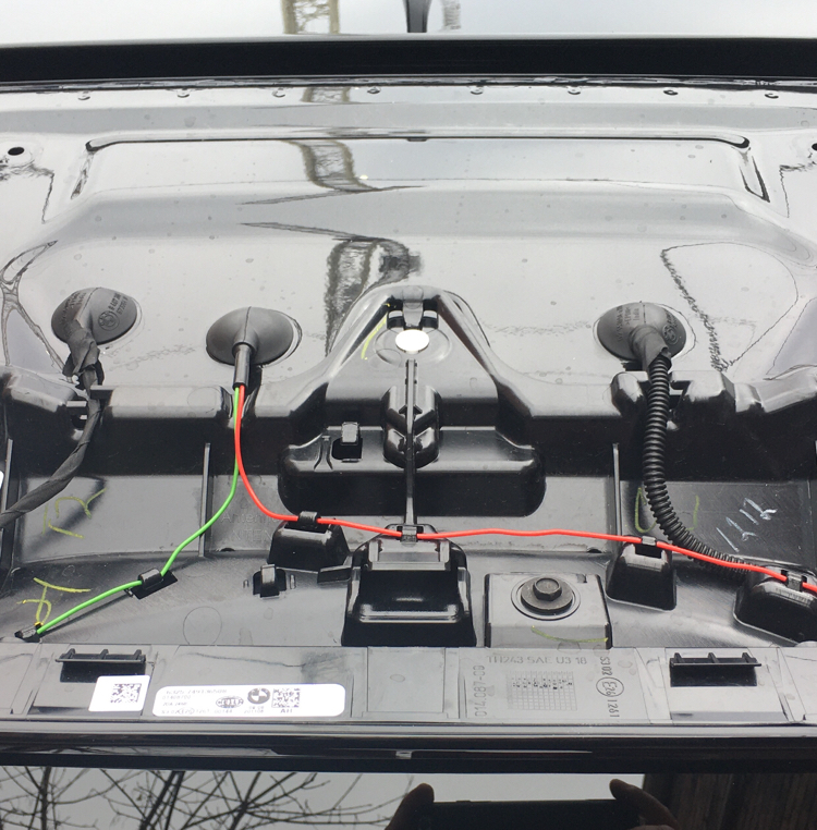

Sorry to use you picture but did you have to trim the 3 tabs that stick up that I have Circled? Mine wouldn't set right at all on top of the 3rd Brake light without trimming them down.
Yes you do have to trim down about half an inch on those two tabs otherwise it will raise a gap between the 3rd brake light and edge of spoiler. I just did mine today

You do not have to trim anything. If done correctly, it will fit together properly.
Or else you may be dealing with a squeak/rattle.

I didn't have make any adjustments fits perfectly. Little tricky lining up the tabs but otherwise straight forward. Just tilt the spoiler just a bit upward so the tabs line up then drop it back down and push forward.

Its not the tab that need to be trim but the 2 raise up slot that sit right in middle about 2 inches in the spoiler on top of brake light that need to be trim down about half n inch. Otherwise it will not sit seamlessly. Those other tabs go in the holes are perfectly fine

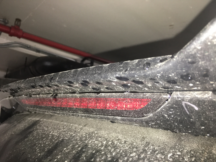

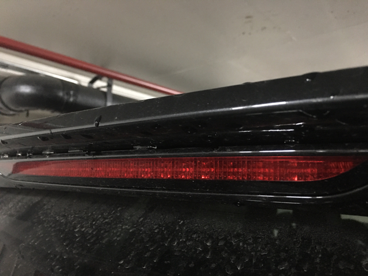

Here is the picture from my local X5MC.
It has gap by default on X5MC.

I'll take a picture of mine tomorrow. But there was no gap. Interesting if it's normal or a factory install issue.
This picture is a zoomed in.

I have many X5M customers, at least 2 of them that I paid attention to, both have gap.

Yes you are correct there is a small gap above the 3rd brake light.

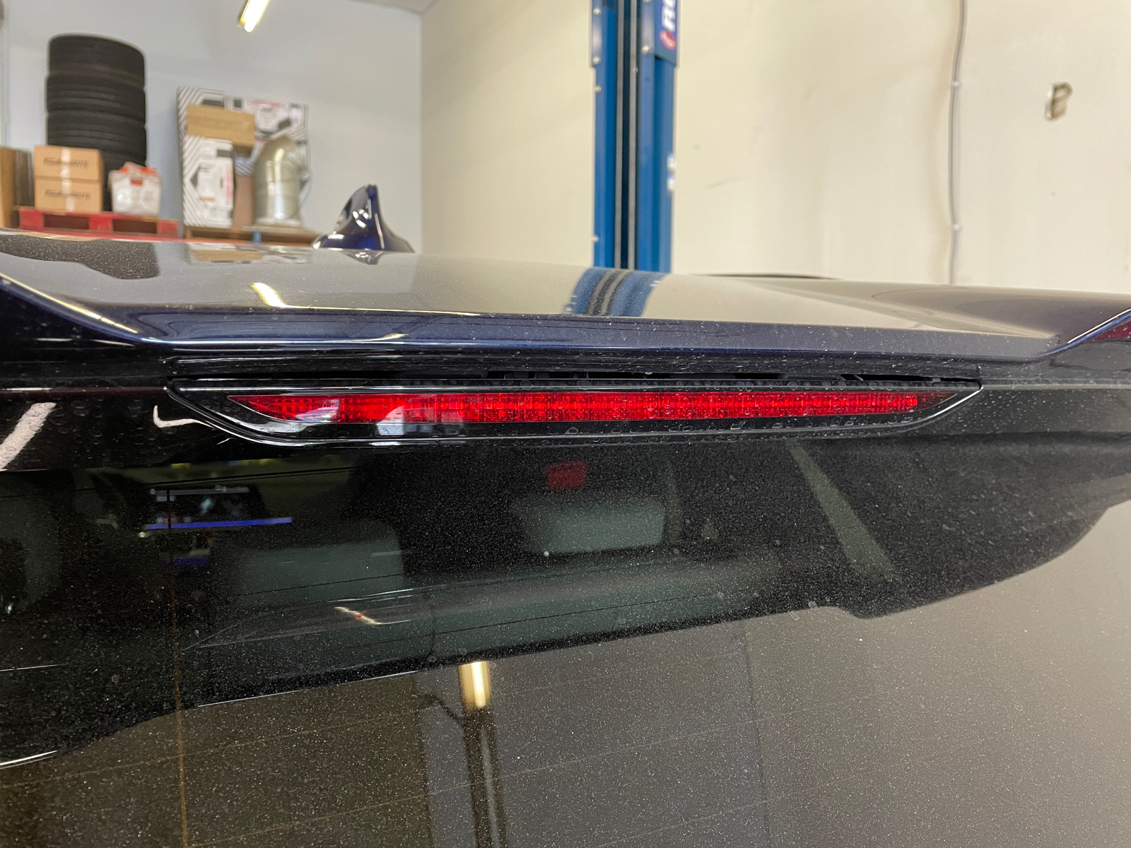

Thanks RGsport for understand what im talking about. For some people with dark color car like grey or black wouldnt see it much because it blend in. But my car is mineral white so contrast with the 3rd brake light its a very noticeable gap. I trimmed kit down half inch. Now it sitting flush.

I added double sided tape to fill-in the gap.

Gotcha. That work. But for me. My o.c.d kick in so i had to trim for a seamlessly look.
