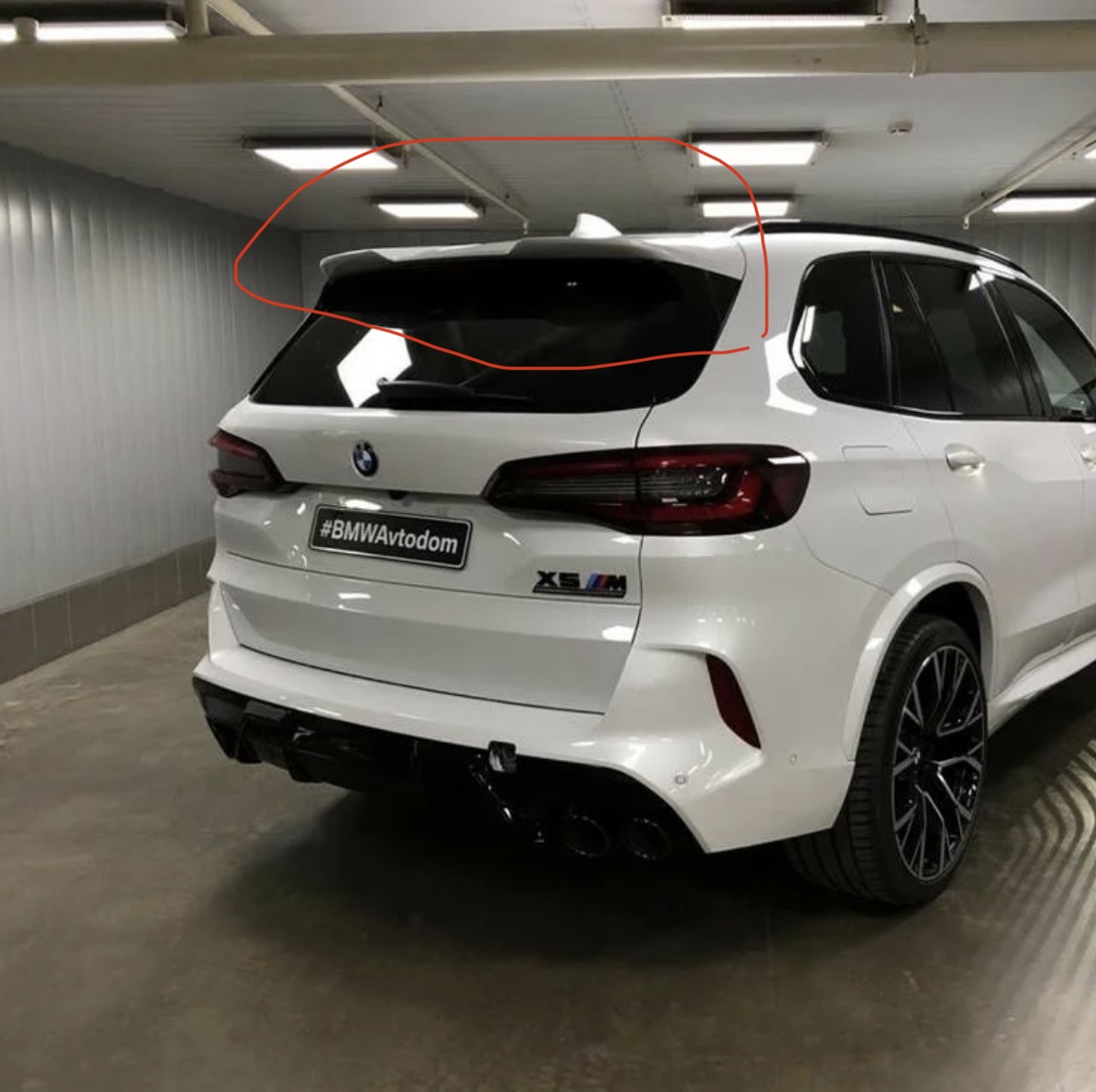

Hello everyone, i have g05 m sport 40i and i was wondering if it is possible to get a roof spoiler exactly like on X5M? I dont like the design of those ebay kits. Please give links and share photos if you have done. An image attached to this post, provided by the poster

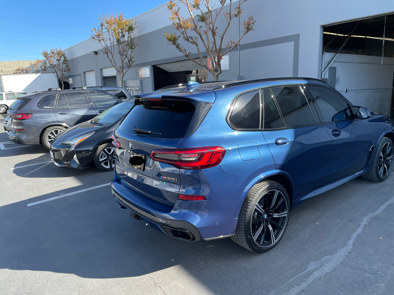

Just did one for local customer. :)

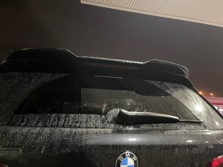

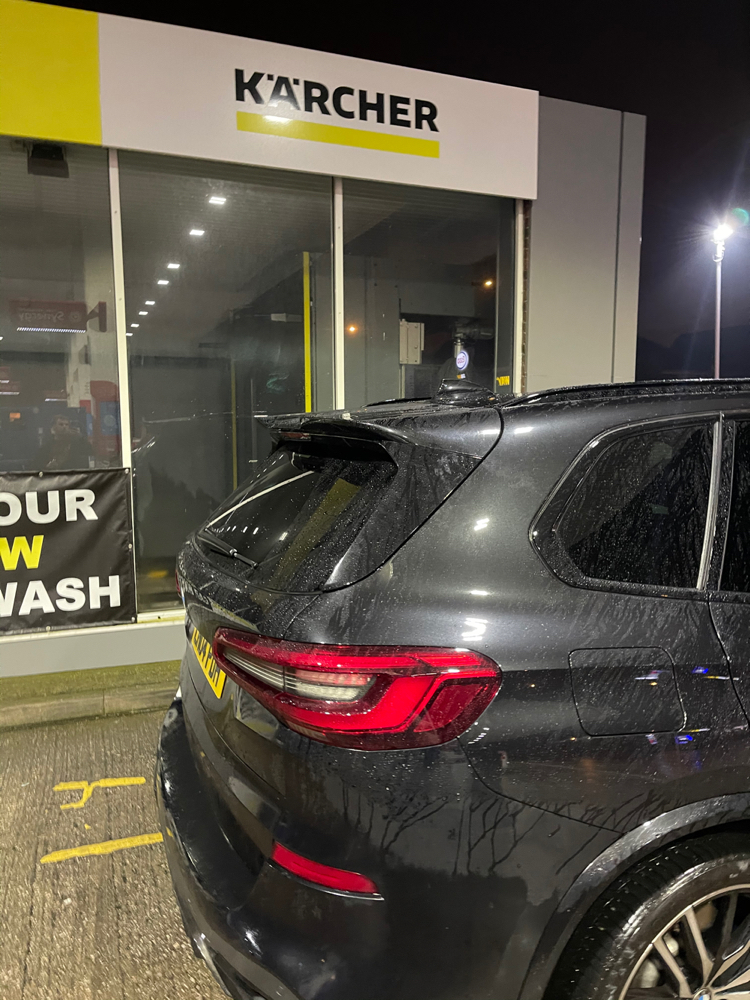

I've just fitted it to mine and think it looks good

Thanks for the pics. Much nicer than the standard spoiler. Where did you buy it and how much did it cost? Did you fit it yourself?
Cheers
01-22-2021
Looks great, look forward to change to it as well.
I can see you have carbon diffuser as well, look great :thumsup:

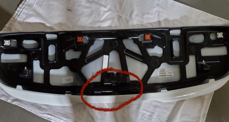

01-23-2021
VetteZ06 wrote
Look great I've also ordered one. Was there any clips to remove?

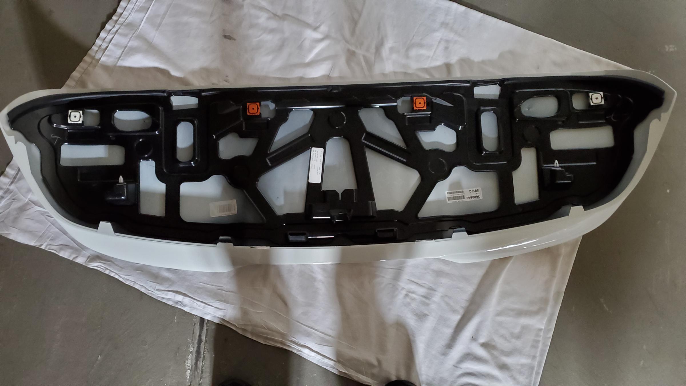

Attached is the underside of the factory installed spoiler that comes on the X5M. The two white clips are on each side just about midway down. And boy did they hold on pretty well for dear life. Be prepared for a loud pop when each one lets go. I thought I broke the spoiler when I heard it.
Sorry to use you picture but did you have to trim the 3 tabs that stick up that I have Circled? Mine wouldn't set right at all on top of the 3rd Brake light without trimming them down.

01-24-2021
Then you were installing it incorrectly. Those 3 tabs need to connect to the proper locations in the lower part of the spoiler near the third brake light. Keeps away the squeaks and rattles.
